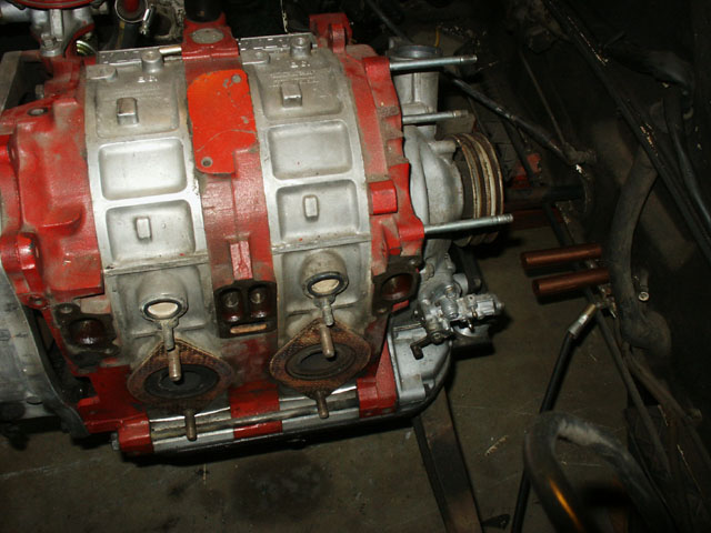

Hi All,
I've been lurking around for a while now and felt it's time to get off my A$$ and put a teener back into my life. I went and rolled my last project car out of my ma's garage, a 1974 2.0 914. It has some rust issues in the rear trunk and the PO had some crappy repairs done to it, but I'm not complaining. This car has been sitting for over 10 years in my ma's garage. This would be my second rotary 914. The first rotary 914 I ever had was over 10 years ago, and it survived stop and go traffic and a vacation to SF california, I live in LA. It was my daily driver to my first "real" job for 3 years. But 3 years of daily driving really took it's toll on my poor 914 and lack of parking forced me to send it to the autobahn in the sky. I kept all the parts and I'm starting the project again.

Hmmm,, scott thatcher's subie makes 350 HP with the radiator in the back,, I wonder if his cooling set up would work with my engine, my engine is only going to put out 220. Then here is a conversion that doesn't put holes in any trunks!

Rotary'14   another, There's going to be a pre-silencer an...   May 24 2005, 10:40 PM
Rotary'14   Here's how I ran the cooling lines, I know oth...   May 24 2005, 10:43 PM
Rotary'14   forgot pic again!   May 24 2005, 10:44 PM
Rotary'14   one more of back   May 24 2005, 10:49 PM

Rotary'14   http://www.914world.com/bbs2/ht...   May 30 2005, 09:14 AM
Rotary'14   before the intake went on,,,,   May 30 2005, 09:16 AM
Rotary'14   This is the gap between the intake manifold and th...   May 30 2005, 09:25 AM

Rotary'14   Well the engine is in, for now,, It'll probabl...   May 31 2005, 10:50 PM
