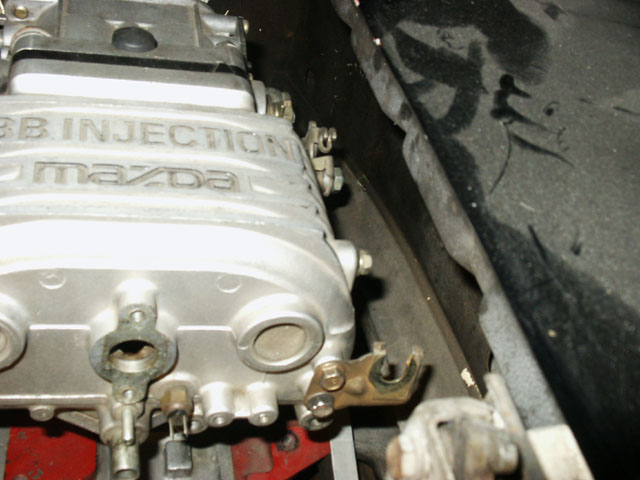

This is the gap between the intake manifold and the rear trunk,, plenty of clearance!
