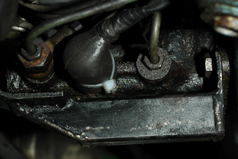

Smurf Zone ![]() ![]() ![]() Group: Members Posts: 525 Joined: 16-August 04 From: Beaverton, OR Member No.: 2,547 |
This was my solution for 74. 1 side brace bolts directly to the MC at the firewall. The other side just outta shot on the left bends up at 90degrees & bolts in with 2 bolts & some large washers.
only downside is you have to cut the pan to clean the beams cross section. Attached thumbnail(s)

URY914 Do the hose clamps give you enough strength to hol... Jun 7 2005, 07:30 AM
Travis Neff Not yet for the Aluminum, but that is next on the ... Jun 7 2005, 09:05 AM
URY914 I like it. Damn good idea. http://w... Jun 7 2005, 09:08 AM
Travis Neff Trev,
That is another good approach to the flexin... Jun 7 2005, 11:28 AM
