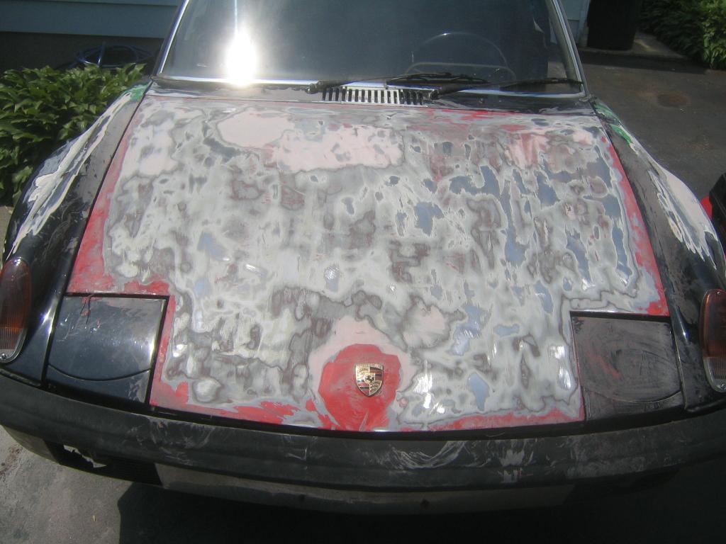

i love porsche   ok...started stripping the front hood and fenders....   Jun 7 2005, 10:50 AM
i love porsche   rust is fun!   Jun 7 2005, 10:51 AM
i love porsche   test fit of the new piece   Jun 7 2005, 10:51 AM
i love porsche   all welded up   Jun 7 2005, 10:52 AM
i love porsche   it follows the curve pretty nicely IMO   Jun 7 2005, 10:53 AM
