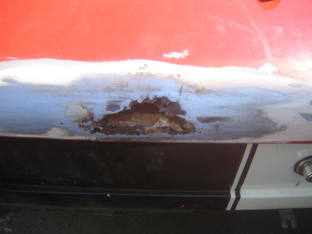

i love porsche   after teh first coat of stripper   Mar 15 2005, 10:00 PM
i love porsche   after the second coat   Mar 15 2005, 10:01 PM
i love porsche   so how do you guys suppose i should repair this?   Mar 15 2005, 10:02 PM

rick 918-S   Fix it right. You'll be happier in the long ru...   May 3 2005, 05:13 PM
