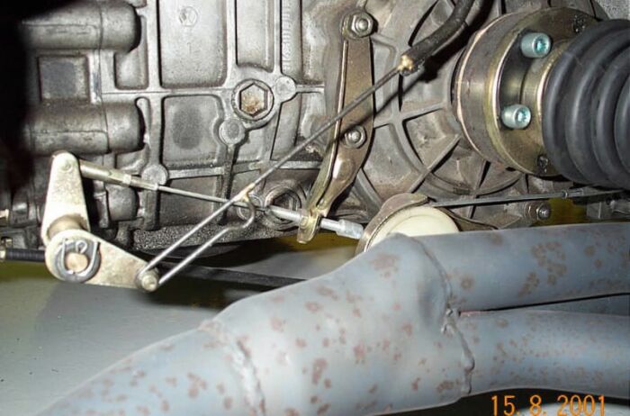

I am trying to fit my throttle, and bell crank and I need a pic to show me how it all goes together. I think that my bell crank will not work. It is from a 911. Any info?

OK, I found the pic that I was looking for ( in a previous thread of mine (IMG:http://www.914world.com/bbs2/html/emoticons/rolleyes.gif) )
I still need to find an OE crank, though. Mine turns the wrong way. Maybe I can heat it and change its direction?

Dr Evil   I'm hoping that it is low temp welded. I am go...   Jun 19 2005, 10:05 AM
Dr Evil   Ok, here is the latest. I used the MAPP gas and he...   Jun 19 2005, 12:23 PM
Eddie Williams   sounds like you need a brazing rod   Jun 19 2005, 01:37 PM
Dr Evil   I just bought one, but I am concerned that the MAP...   Jun 19 2005, 01:41 PM
Dr Evil   Its not pretty, but where the metal was thinner ar...   Jun 19 2005, 02:01 PM
Red-Beard   MAPP gas is perfectly hot enough for brazing. Braz...   Jun 19 2005, 02:15 PM
Dr Evil   Ta da!   Jun 19 2005, 02:15 PM
Dr Evil   They were brazed to begin with, though. It should ...   Jun 19 2005, 02:18 PM
