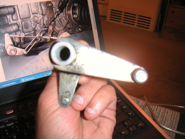

I am trying to fit my throttle, and bell crank and I need a pic to show me how it all goes together. I think that my bell crank will not work. It is from a 911. Any info?

Here is mine

McMark   Looks like http://www.914wo...   Jun 19 2005, 12:38 AM
Dr Evil   I'm hoping that it is low temp welded. I am go...   Jun 19 2005, 10:05 AM
Dr Evil   Ok, here is the latest. I used the MAPP gas and he...   Jun 19 2005, 12:23 PM
Eddie Williams   sounds like you need a brazing rod   Jun 19 2005, 01:37 PM
Dr Evil   I just bought one, but I am concerned that the MAP...   Jun 19 2005, 01:41 PM
Dr Evil   Its not pretty, but where the metal was thinner ar...   Jun 19 2005, 02:01 PM
Red-Beard   MAPP gas is perfectly hot enough for brazing. Braz...   Jun 19 2005, 02:15 PM
Dr Evil   Ta da!   Jun 19 2005, 02:15 PM
Dr Evil   They were brazed to begin with, though. It should ...   Jun 19 2005, 02:18 PM
trekkor   And here's the cool one... http...   Jun 19 2005, 02:18 PM
Aaron Cox   cool deal. does it run yet?   Jun 19 2005, 02:19 PM
Red-Beard   <...   Jun 19 2005, 02:24 PM
Dr Evil   Nope, I had to buy the rods. $3 and it is pre...   Jun 19 2005, 02:29 PM
