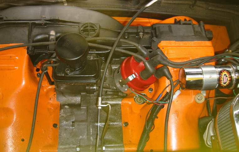

So I've got the Mallory in there and everything seems to be working great. But I am having a bit of trouble adjusting the timing.
The Mallory fits in real nice but it's limited as to how far clockwise it can turn because the rotor cap clips bump into the tin.
I think I've got just enough advance, but I'd like to be able to move it a bit more. The only thing I can think to do is to modify the tin to give it room to move.
Does anyone else have a similar set up???
Here's a picture of what I'm looking at.....
Thank you!
Nate

Mueller   move the 1 wire to 4, 4 wire to 3, 3 wire to 2, 2 ...   Jun 20 2005, 04:28 PM
Jake Raby   And you had better throw that coil away, or add a ...   Jun 20 2005, 04:32 PM
Natedog   You guys are FAST! ...   Jun 20 2005, 04:37 PM
