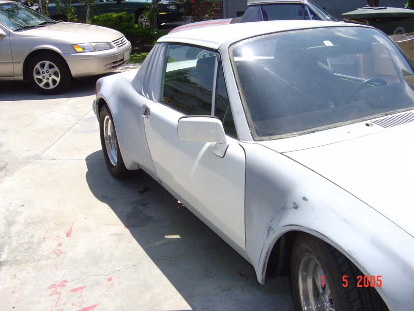

Well, I finally got around to taking some measurements. I did not take the mirrors off, but rather took measurements from 3 points on each door to the base of the rubber gasket. On this first picture...the key to the alignment is the yellow line...that line when looking at the car from the front should be vertical on both sides!
Also, for strength, you must use the 911 backing plate. I riveted mine on after having the holes cut in.

post Jun 21 2005, 06:36 PM
Born to Drive
Posts: 7,910
Joined: 26-December 02
From: Costa Mesa, CA
Member No.: 17
Mine are further forward. They seem to work just fine with my seat all the way back I can see out both with no problem. I mounted them that way because the passenger side door already had one mounted so I just mounted the drivers side in the same approximate location so it would match.

skline   Mine are further forward. They seem to work just f...   Jun 21 2005, 06:36 PM
skline   Here is the side I mounted up.   Jun 21 2005, 06:37 PM
