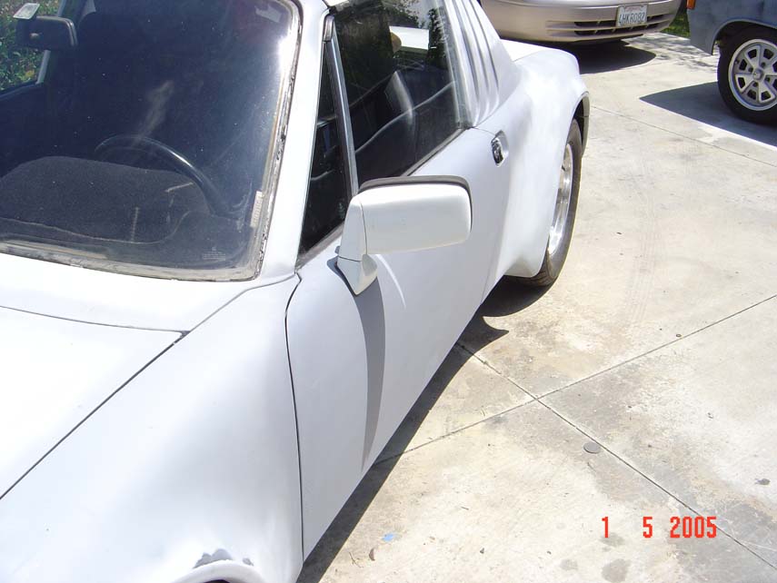

post Jun 21 2005, 06:37 PM
Born to Drive
Posts: 7,910
Joined: 26-December 02
From: Costa Mesa, CA
Member No.: 17
Here is the side I mounted up.

markb   Has anybody thought of mounting them farther forwa...   Jun 21 2005, 06:13 PM
skline   Mine are further forward. They seem to work just f...   Jun 21 2005, 06:36 PM
skline   Here is the side I mounted up.   Jun 21 2005, 06:37 PM
