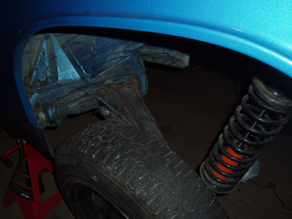

I'm going to do a no no. and not resize the pics. lazy? yes.
Mike M. Will 18's really fit under here?????
