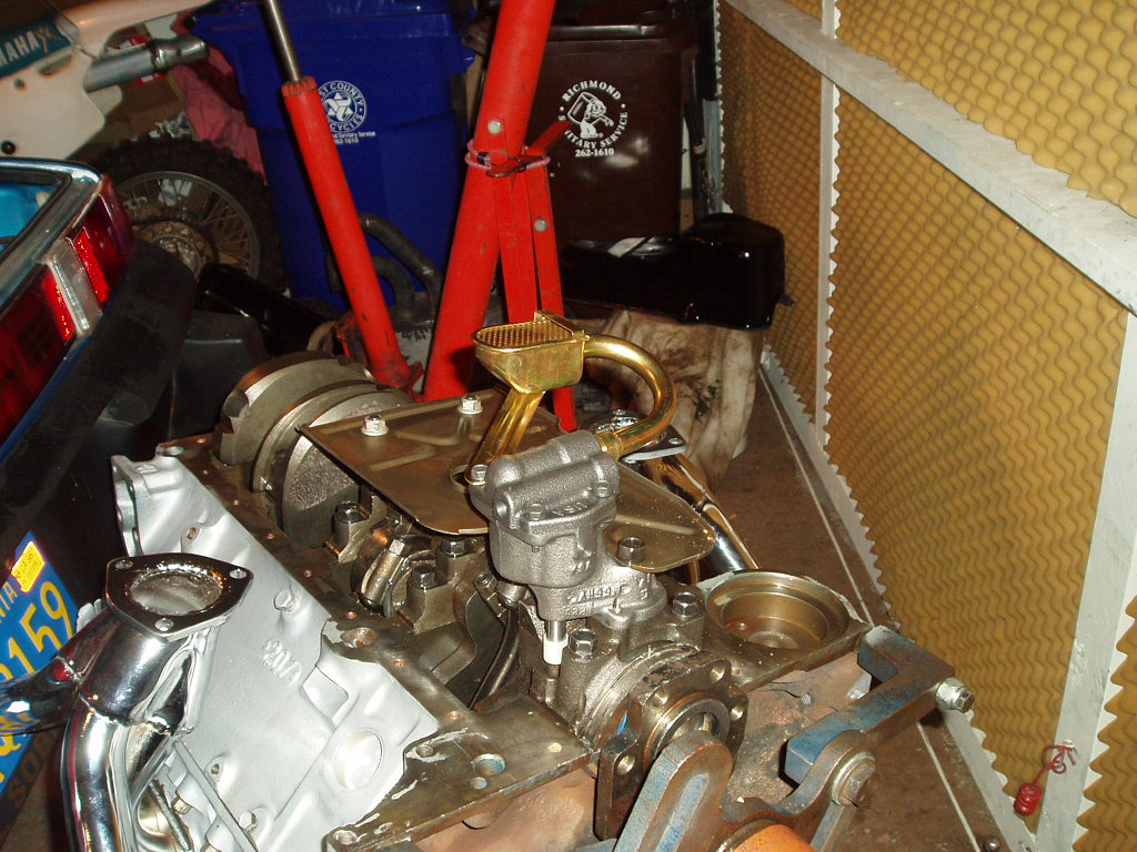

Oh and my big progress for the evening.... an oil pickup... =-)
Hey i promised myself every night i'd do SOMETHING... LOL
