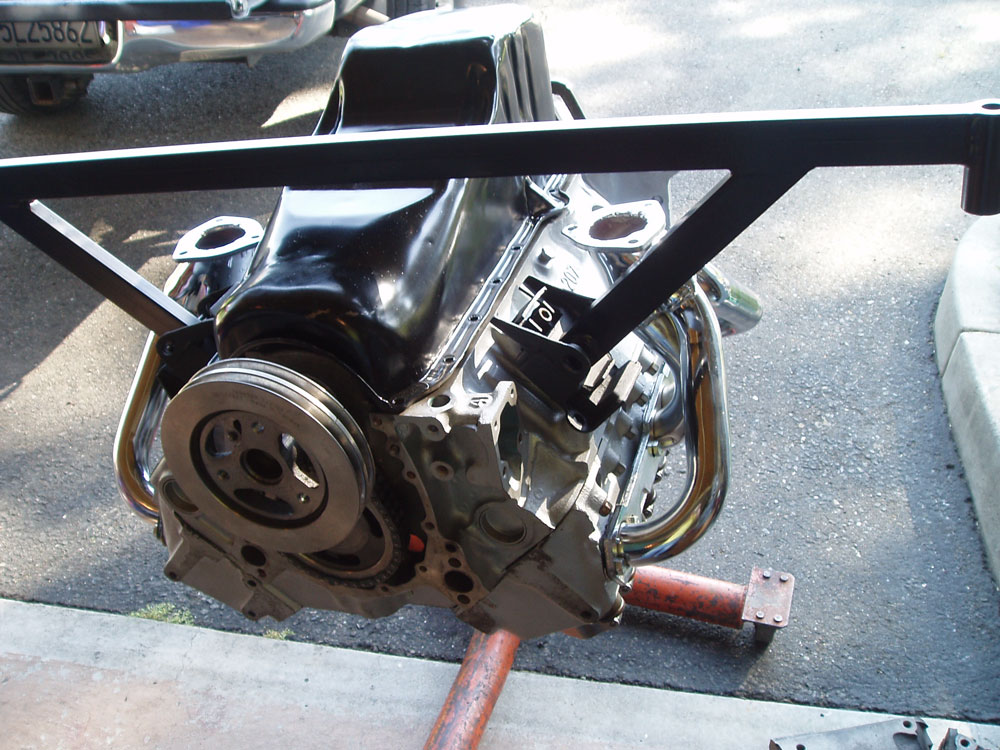

Dr. Roger   This evenings updates. Got the radiator via UPS. ...   Jun 29 2005, 01:01 AM
Dr. Roger   With fans roughly in place. Anyone have a V8 and ...   Jun 29 2005, 01:03 AM
Dr. Roger   engine tonight   Jun 29 2005, 01:05 AM
