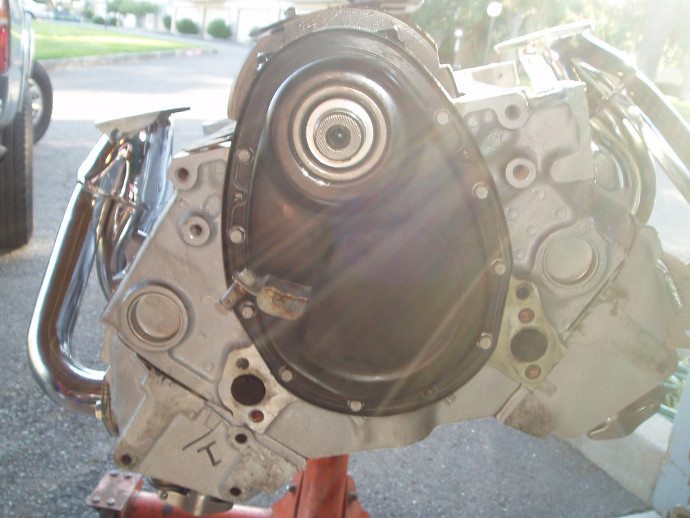

Pulley spacer in and front cover on.

Dr. Roger   Pulley spacer in and front cover on.   Jun 25 2005, 12:18 AM
