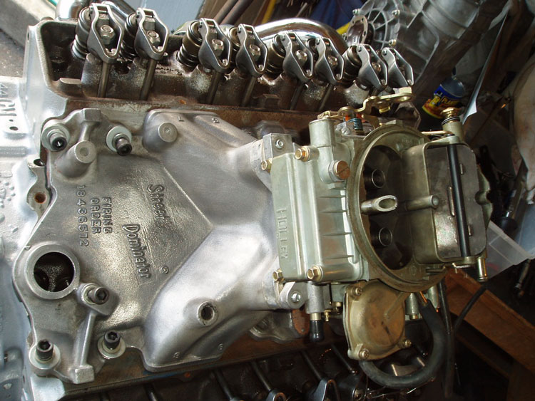

Dr. Roger   ....Heads assembled. Newly rebuilt "Otto's" 9...   Jun 18 2005, 11:06 AM
Dr. Roger   ....   Jun 18 2005, 11:07 AM
redshift   Your intake manifold has more bhp than my motor. ...   Jun 18 2005, 11:08 AM
Dr. Roger   ...   Jun 18 2005, 11:08 AM
Dr. Roger   test fit, test fit, test fit....... all good.   Jun 18 2005, 11:08 AM
Dr. Roger   ....   Jun 18 2005, 11:08 AM
Dr. Roger   Miles, http://www.914world.com/...   Jun 18 2005, 11:47 AM
ewdysar   Your manifold looks a little tall. You may run in...   Jun 20 2005, 06:04 PM
Dr. Roger   Yes Eric, There will be a clearance issue. I...   Jun 20 2005, 06:31 PM
