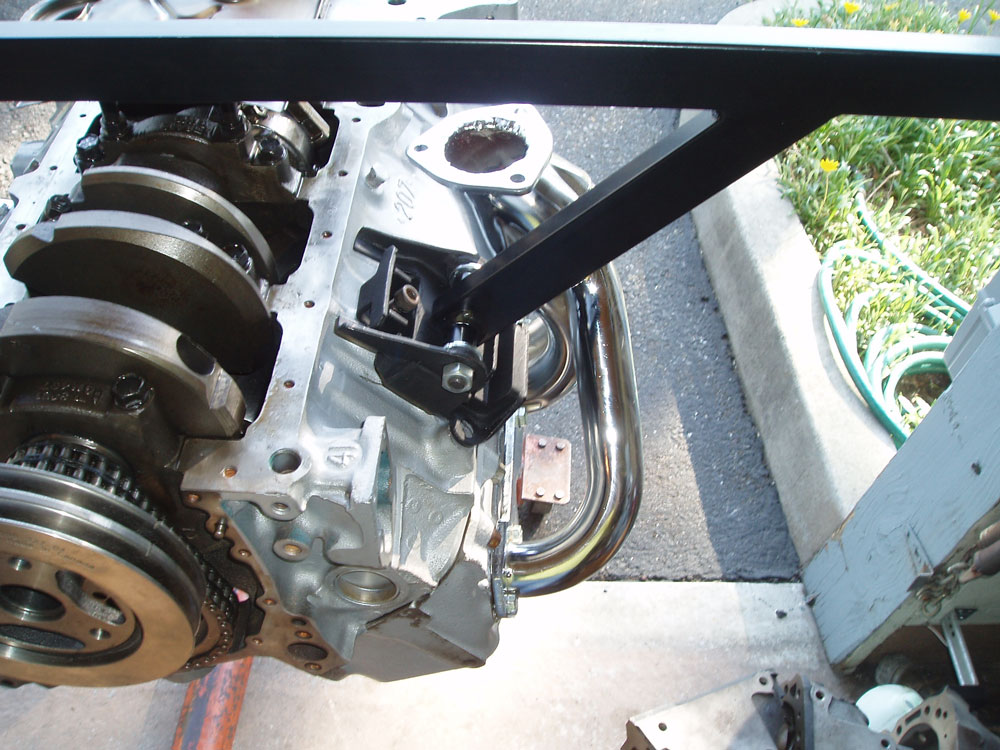

John2kx Roger,
Many have run into this problem and the ca... Jul 6 2005, 05:31 PM
Dr. Roger John,
The pic is with the bolts not torqued down y... Jul 6 2005, 07:06 PM
Dr. Roger Yep, tonight was a learning experience.
I learned... Jul 6 2005, 11:59 PM
