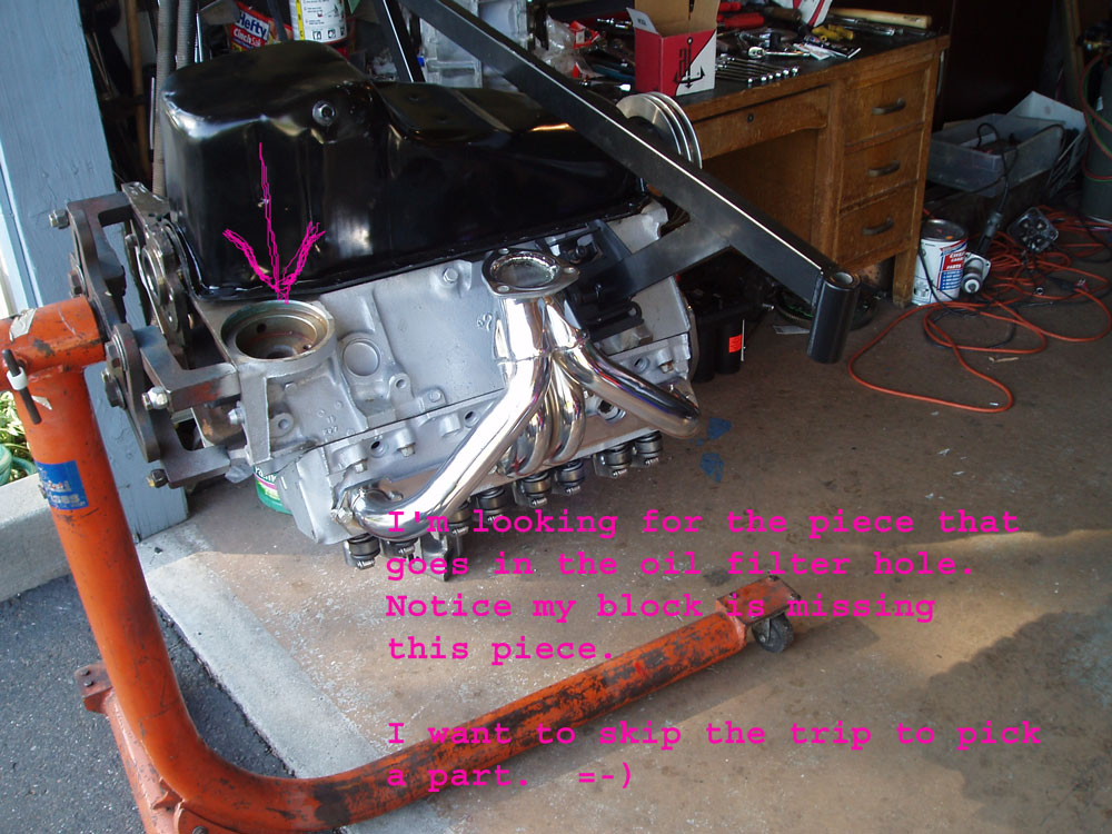

914GT Sorry, checked my parts pile and I don't have ... Jun 25 2005, 01:30 PM
Dr. Roger Yep, according to my spin-on conversion kit, this ... Jun 25 2005, 01:40 PM
Dr. Roger bypass valve assembly pic. 2 bolts hold it in. ... Jun 25 2005, 01:46 PM
