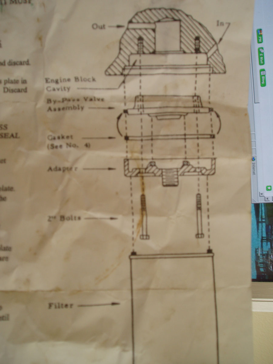

bypass valve assembly pic. 2 bolts hold it in. Adaptor goes on top of it.
Doesn't anyone have one of these just sitting around???? (IMG:http://www.914world.com/bbs2/html/emoticons/huh.gif) (IMG:http://www.914world.com/bbs2/html/emoticons/biggrin.gif)

Dr. Roger   bump http://www.914world.com/...   Jun 25 2005, 01:01 PM
914GT   Sorry, checked my parts pile and I don't have ...   Jun 25 2005, 01:30 PM
Dr. Roger   Yep, according to my spin-on conversion kit, this ...   Jun 25 2005, 01:40 PM
Dr. Roger   bypass valve assembly pic. 2 bolts hold it in. ...   Jun 25 2005, 01:46 PM
