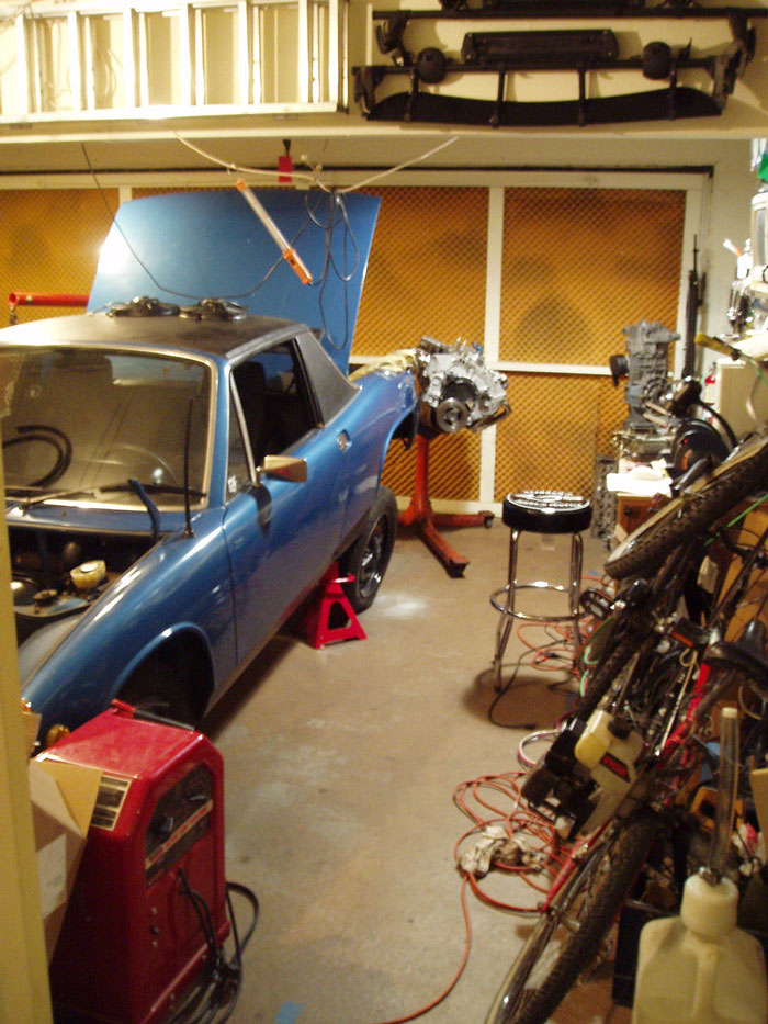

Welcome to my lab, and let's see what's on the slab....

Dr. Roger   ....Heads assembled. Newly rebuilt "Otto's" 9...   Jun 18 2005, 11:06 AM

ewdysar   Your manifold looks a little tall. You may run in...   Jun 20 2005, 06:04 PM
Dr. Roger   Yes Eric, There will be a clearance issue. I...   Jun 20 2005, 06:31 PM

914GT   A few suggestions ... - With those headers make s...   Jun 20 2005, 07:57 PM

914GT   I use the orange Permatex but the other 'flavo...   Jun 21 2005, 10:13 AM
Dr. Roger   Yea', i'm lookin' for some "cam lope" ...   Jun 21 2005, 10:26 AM

Dr. Roger   I'm going to do a no no. and not resize the p...   Jun 21 2005, 10:40 PM

Dr. Roger   Dang it. I cannot find the last shorty head bolt ...   Jun 23 2005, 10:26 AM
914GT   Recommend a Melling oil pump drive shaft and not u...   Jun 23 2005, 10:32 AM

Dr. Roger   Cool. As tonight the bottom end is buttoned up a...   Jun 26 2005, 11:14 PM

Dr. Roger   This evenings updates. Got the radiator via UPS. ...   Jun 29 2005, 01:01 AM
Dr. Roger   With fans roughly in place. Anyone have a V8 and ...   Jun 29 2005, 01:03 AM
Dr. Roger   engine tonight   Jun 29 2005, 01:05 AM
Dr. Roger   With the first cuts in the front trunk, I kinda...   Jun 30 2005, 12:12 AM

Andyrew   So.... Why did you cut that area for the inlet? ...   Jun 30 2005, 01:11 AM
Dr. Roger   Andy, I think it was 914GT's pics where I got ...   Jun 30 2005, 10:03 AM

Dr. Roger   Little update. Picked up 2 pieces approx. 1 1/4" ...   Jul 3 2005, 01:08 PM
914GT   Roger, you sure you want to trust epoxy for that? ...   Jul 3 2005, 01:18 PM
Dr. Roger   What kind? Regular old galvanized. =-) I...   Jul 3 2005, 01:24 PM
John2kx   Roger, I recommend the well tested hose and routi...   Jul 3 2005, 05:26 PM

Dr. Roger   I didn't light it tonight. Here's why.... ...   Jul 6 2005, 01:56 AM

John2kx   Roger, Many have run into this problem and the ca...   Jul 6 2005, 05:31 PM
Dr. Roger   John, The pic is with the bolts not torqued down y...   Jul 6 2005, 07:06 PM
Dr. Roger   Yep, tonight was a learning experience. I learned...   Jul 6 2005, 11:59 PM
