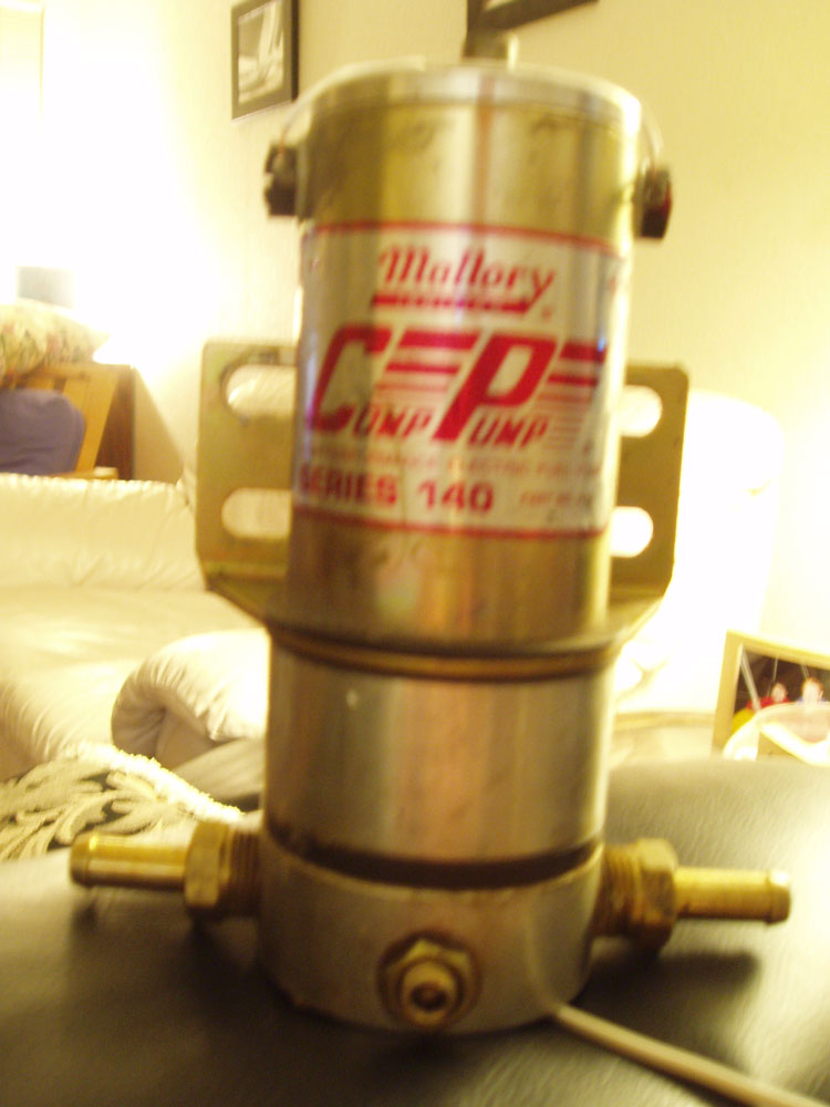

great deal on a QUIET fuel pump. =-)
Part of the secret of a quiet fuel pump is to keep it isolated from the body of the car. HUGE difference. I ended up suspending mine with heavy duty zip ties... Very quiet.

Dr. Roger   great deal on a QUIET fuel pump. =-) Part of th...   Jun 27 2005, 01:52 AM
ewdysar   Ha, I have one of those pumps on the shelf. It wa...   Jun 28 2005, 01:28 PM
lybones   I need that exact same part for my H.O crate motor...   Jun 28 2005, 02:35 PM
