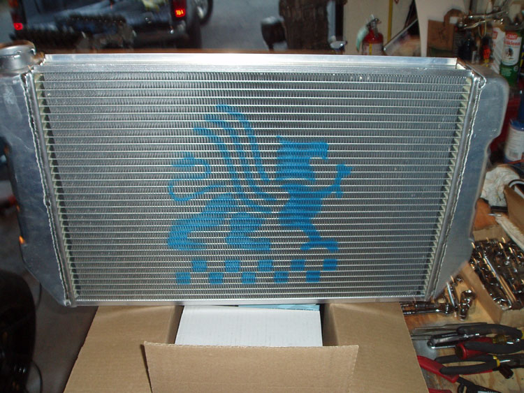

This evenings updates.
Got the radiator via UPS. Looks like the fans will fit well on it with a shroud.
Got intake and carb on. Dizzy on. Front motor mount on.
Previous pics were test fits. =-)
Oh yea', and finally found a cheap bypass valve online... What a pain in the arse.

Dr. Roger   This evenings updates. Got the radiator via UPS. ...   Jun 29 2005, 01:01 AM
Dr. Roger   With fans roughly in place. Anyone have a V8 and ...   Jun 29 2005, 01:03 AM
