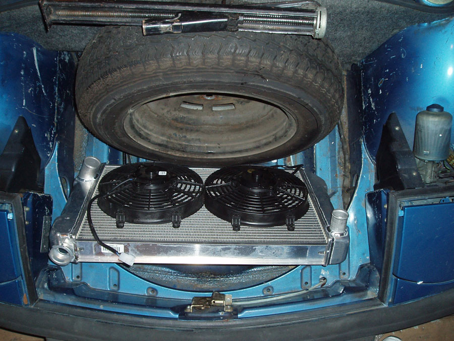

With fans roughly in place.
Anyone have a V8 and keep their spare tire too???? Attached thumbnail(s)
