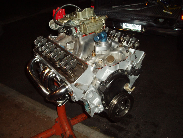

Dr. Roger   engine tonight   Jun 29 2005, 01:05 AM
