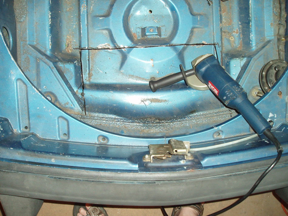

With the first cuts in the front trunk, I kinda' feel like I'm deflowering my 14.
I'll get over it quick. =-)
Damn it, I told myself "no more toes in any pics"....

Dr. Roger   With the first cuts in the front trunk, I kinda...   Jun 30 2005, 12:12 AM
Eric Taylor   Looks good man http://www.914world....   Jun 30 2005, 12:56 AM
Andyrew   So.... Why did you cut that area for the inlet? ...   Jun 30 2005, 01:11 AM
Dr. Roger   Andy, I think it was 914GT's pics where I got ...   Jun 30 2005, 10:03 AM
Dr. Roger   Whoops, sorry Eric for lagging.... I'm going ...   Jun 30 2005, 06:21 PM
