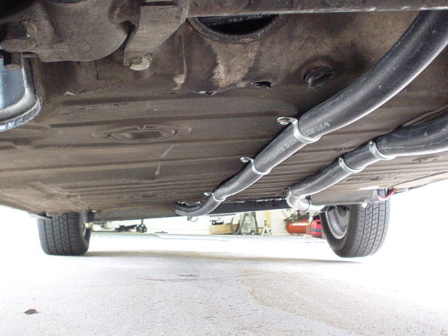

John2kx   Roger, I recommend the well tested hose and routi...   Jul 3 2005, 05:26 PM
John2kx   Renegades' green strip hose secured with condu...   Jul 3 2005, 05:37 PM
John2kx   plenty of room for speed bumps or "off track" even...   Jul 3 2005, 05:37 PM
