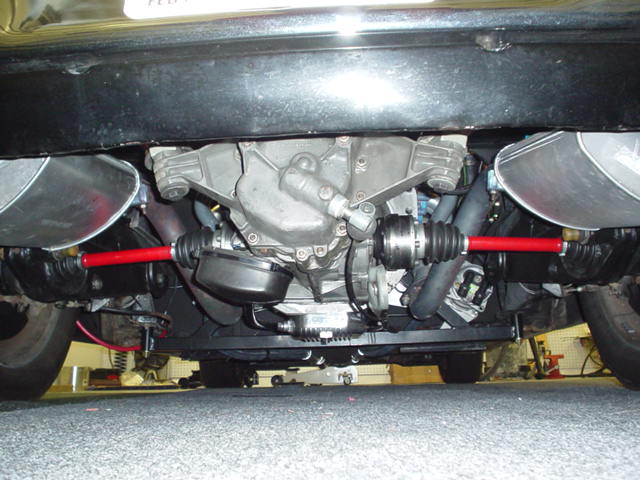

Dr. Roger   Little update. Picked up 2 pieces approx. 1 1/4" ...   Jul 3 2005, 01:08 PM
914GT   Roger, you sure you want to trust epoxy for that? ...   Jul 3 2005, 01:18 PM
Dr. Roger   What kind? Regular old galvanized. =-) I...   Jul 3 2005, 01:24 PM
John2kx   Roger, I recommend the well tested hose and routi...   Jul 3 2005, 05:26 PM
John2kx   Renegades' green strip hose secured with condu...   Jul 3 2005, 05:37 PM

John2kx   Roger, Many have run into this problem and the ca...   Jul 6 2005, 05:31 PM
Dr. Roger   John, The pic is with the bolts not torqued down y...   Jul 6 2005, 07:06 PM
Dr. Roger   Yep, tonight was a learning experience. I learned...   Jul 6 2005, 11:59 PM
