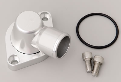

Bill,
Found this 360 degree swivel thermostat housing: CSR Performance Products CSI-912C at Summit

neo914-6   Bill, Found this 360 degree swivel thermostat hou...   Jul 3 2005, 05:40 PM
