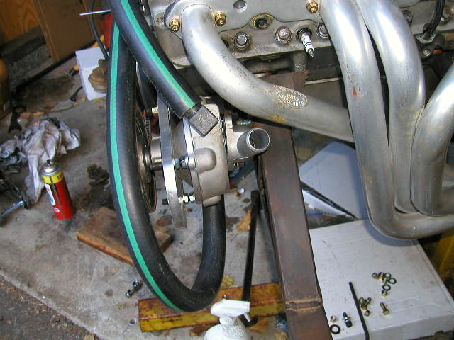

Brad and crew got my 20+ year old Jaide conversion resurrected a couple of years ago but I couldn't leave well enough alone. A fellow V8 converter sold me his built 400hp engine before Christmas and I thought I could get it installed by the April's WCC05 by merely replacing the clutch and rebuilding the old Carter carb. The KEP clutch turned into a fiasco so I decided to buy an all new Renegade kit (less the engine and tranny mounts) besides I already had their great radiator. Bill P gave me some v-belt parts since he was going serpentine and Renegade gave me a nice deal on the w/p for supporting them over the years. Well I come to find this is not a week-end bolt-in so here are my woes and triumphs…

Still have the w/p inlet pointing up or down into the engine mount. The tstat inlets are usually 1 1/2" and this is 1 1/4". Alot have o-rings too so the search will continue at Speed Merchant and more FLAPS tomorrow...

neo914-6   Bill, that hose goes ~300 degrees around the pump...   Jul 3 2005, 05:05 PM
neo914-6   I'm liking AN fittings like on Chris' car....   Jul 3 2005, 05:08 PM
nine14cats   I asked Mike about the routing of the hose. He sa...   Jul 3 2005, 05:08 PM
neo914-6   Bill, Found this 360 degree swivel thermostat hou...   Jul 3 2005, 05:40 PM

neo914-6   Ok, test rotated the water pump like Bills with on...   Jul 4 2005, 07:11 PM
neo914-6   w/p inlet is okay but the fitting is right up to t...   Jul 4 2005, 07:12 PM
neo914-6   plastic 1" are in right orientation but the inlet ...   Jul 9 2005, 12:46 PM
