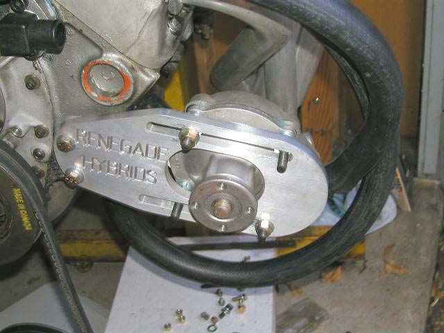

Brad and crew got my 20+ year old Jaide conversion resurrected a couple of years ago but I couldn't leave well enough alone. A fellow V8 converter sold me his built 400hp engine before Christmas and I thought I could get it installed by the April's WCC05 by merely replacing the clutch and rebuilding the old Carter carb. The KEP clutch turned into a fiasco so I decided to buy an all new Renegade kit (less the engine and tranny mounts) besides I already had their great radiator. Bill P gave me some v-belt parts since he was going serpentine and Renegade gave me a nice deal on the w/p for supporting them over the years. Well I come to find this is not a week-end bolt-in so here are my woes and triumphs…

Ok, test rotated the water pump like Bills with one hose going all around the outside of the pump.

neo914-6   Which brings me to my "July" issues... 1. Per Sc...   Jul 3 2005, 02:08 AM
neo914-6   Notice how "wide" the Jaide engine mount is? Here...   Jul 3 2005, 02:11 AM
neo914-6   2. that hose inlet to xbar is CLOSE...   Jul 3 2005, 02:13 AM
neo914-6   3. My slick Polyurethane engine mounts are "short"...   Jul 3 2005, 02:16 AM

nine14cats   Hi Felix, Your pump location is very similar to m...   Jul 3 2005, 08:43 AM

nine14cats   Felix, Here's a few shots of my RH setup from...   Jul 3 2005, 04:49 PM
nine14cats   water pump   Jul 3 2005, 04:49 PM
nine14cats   #2   Jul 3 2005, 04:49 PM
nine14cats   water pump #3   Jul 3 2005, 04:50 PM
nine14cats   WP#4   Jul 3 2005, 04:50 PM
neo914-6   Bill, that hose goes ~300 degrees around the pump...   Jul 3 2005, 05:05 PM
neo914-6   I'm liking AN fittings like on Chris' car....   Jul 3 2005, 05:08 PM
nine14cats   I asked Mike about the routing of the hose. He sa...   Jul 3 2005, 05:08 PM
neo914-6   Bill, Found this 360 degree swivel thermostat hou...   Jul 3 2005, 05:40 PM
neo914-6   Well some progress. Assembled everything to fit b...   Jul 4 2005, 11:05 AM
neo914-6   To make my Jaide engine cross bar fit, I used my d...   Jul 4 2005, 11:12 AM
neo914-6   Still have the w/p inlet pointing up or down into ...   Jul 4 2005, 11:18 AM
neo914-6   Ok, test rotated the water pump like Bills with on...   Jul 4 2005, 07:11 PM
neo914-6   w/p inlet is okay but the fitting is right up to t...   Jul 4 2005, 07:12 PM
