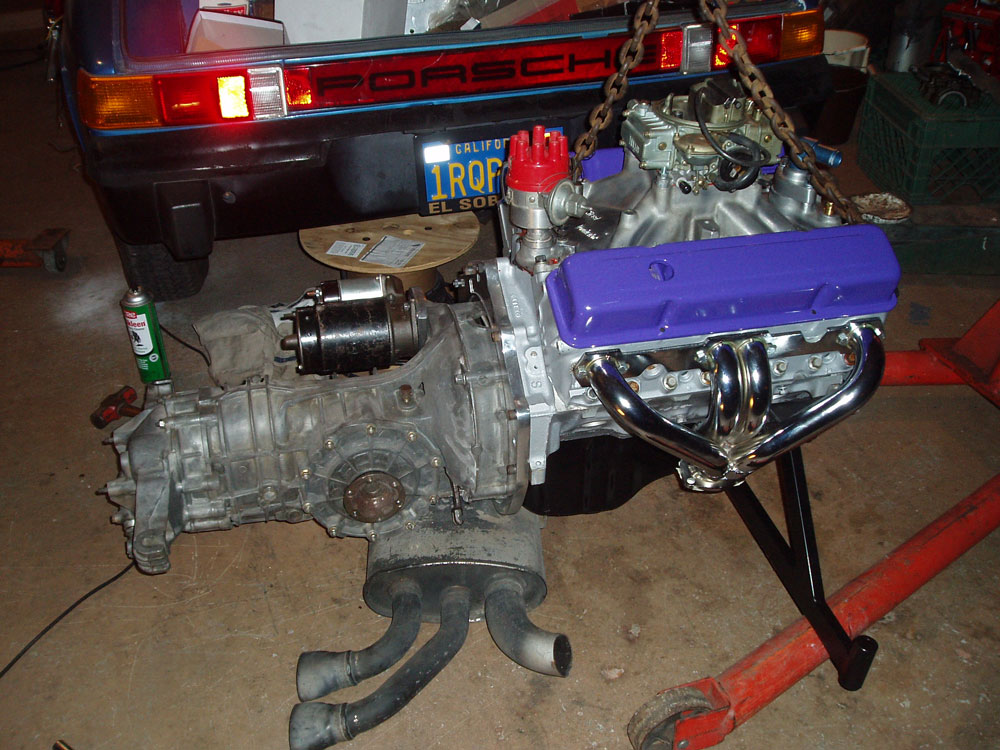

Yep, tonight was a learning experience.
I learned that the tranny will not go on all the way unless the pressure plate is torqued down. Me= dumb shit... I was getting ready to perform surgery on the fork... LOL Tomorrow I pick up some fuel line, hose clamps, distributor clamp down thing, and permatex. Then it's "Fire it up" time!!!!!!! Attached thumbnail(s)
