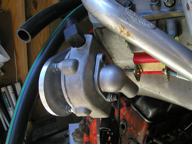

neo914-6   Well some progress. Assembled everything to fit b...   Jul 4 2005, 11:05 AM
neo914-6   To make my Jaide engine cross bar fit, I used my d...   Jul 4 2005, 11:12 AM
neo914-6   Still have the w/p inlet pointing up or down into ...   Jul 4 2005, 11:18 AM
neo914-6   Ok, test rotated the water pump like Bills with on...   Jul 4 2005, 07:11 PM
neo914-6   w/p inlet is okay but the fitting is right up to t...   Jul 4 2005, 07:12 PM
neo914-6   plastic 1" are in right orientation but the inlet ...   Jul 9 2005, 12:46 PM
