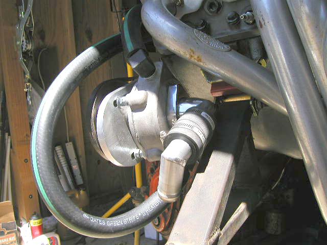

neo914-6   Which brings me to my "July" issues... 1. Per Sc...   Jul 3 2005, 02:08 AM
neo914-6   Notice how "wide" the Jaide engine mount is? Here...   Jul 3 2005, 02:11 AM
neo914-6   2. that hose inlet to xbar is CLOSE...   Jul 3 2005, 02:13 AM

nine14cats   Hi Felix, Your pump location is very similar to m...   Jul 3 2005, 08:43 AM

nine14cats   Felix, Here's a few shots of my RH setup from...   Jul 3 2005, 04:49 PM
nine14cats   water pump   Jul 3 2005, 04:49 PM
nine14cats   #2   Jul 3 2005, 04:49 PM
nine14cats   water pump #3   Jul 3 2005, 04:50 PM
nine14cats   WP#4   Jul 3 2005, 04:50 PM
neo914-6   Bill, that hose goes ~300 degrees around the pump...   Jul 3 2005, 05:05 PM
neo914-6   I'm liking AN fittings like on Chris' car....   Jul 3 2005, 05:08 PM
nine14cats   I asked Mike about the routing of the hose. He sa...   Jul 3 2005, 05:08 PM
neo914-6   Bill, Found this 360 degree swivel thermostat hou...   Jul 3 2005, 05:40 PM

neo914-6   Still have the w/p inlet pointing up or down into ...   Jul 4 2005, 11:18 AM
neo914-6   Ok, test rotated the water pump like Bills with on...   Jul 4 2005, 07:11 PM
neo914-6   w/p inlet is okay but the fitting is right up to t...   Jul 4 2005, 07:12 PM
neo914-6   plastic 1" are in right orientation but the inlet ...   Jul 9 2005, 12:46 PM

neo914-6   Swapped my 1 1/4" and 1 1/2" lines under the car, ...   Jul 9 2005, 01:08 PM
