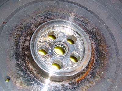

zymurgist   OK, I have a question. Babydoll's flywheel lo...   Jul 10 2005, 08:01 PM
zymurgist   Trying to post a picture.   Jul 10 2005, 08:04 PM
zymurgist   ...and another. Trying to get a good view of the ...   Jul 10 2005, 08:08 PM
