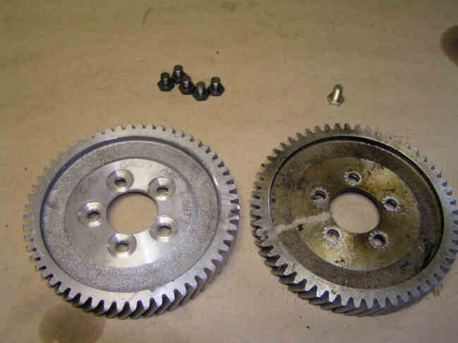

Time to move on to another task. Put the can gear on the cam. The gear is countersunk and the bolts are shortened to make room for the Schadek oil pump. The old gear is on the right with no clearancing.

DNHunt   The gear will only align one way cause the spacing...   Jul 15 2005, 09:51 AM
DNHunt   This is correct. All the holes line up   Jul 15 2005, 09:52 AM
DNHunt   After chasing the bolt holes and cleaning I tighte...   Jul 15 2005, 09:54 AM
