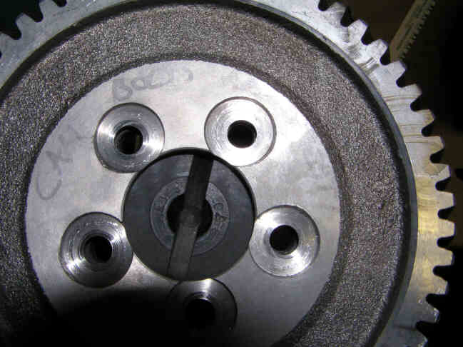

post Jul 15 2005, 09:52 AM
914 Wizard? No way. I got too much to learn.
Posts: 4,099
Joined: 21-April 03
From: Gig Harbor, WA
Member No.: 598
This is correct. All the holes line up
