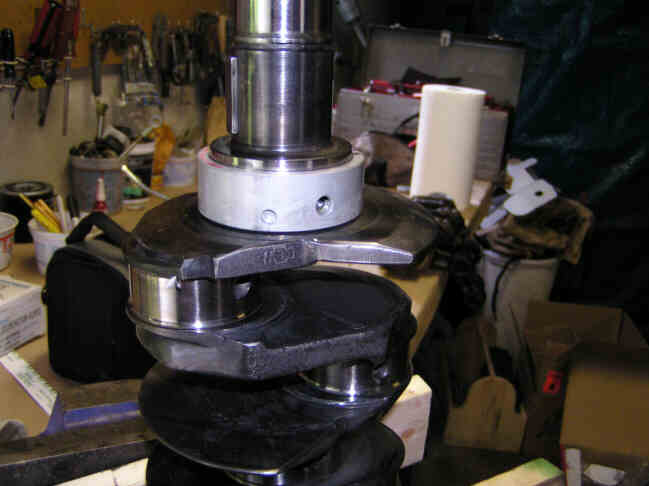

On to the crankshaft. Time to install #3 main bearing, timing gear, spacer, dizzy gear, and retaining ring. #3 bearing is on with hole for dowel toward the flywheel end. The wife is gone and the gears are in the oven heating up. Fortunately, I have about 6 hours to get the smell out.

DNHunt   On to the crankshaft. Time to install #3 main bear...   Jul 15 2005, 09:59 AM
Jake Raby   Lookin good Dave! Glad you are back on it- so...   Jul 15 2005, 10:04 AM
