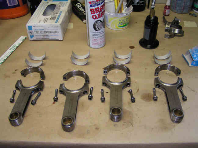

Actually, it wasn't any problem. Everything went fine. I am glat the wife wasn't here though. Just 1 less "nutty" thing to explain.
Laid out the rods and bearings.
