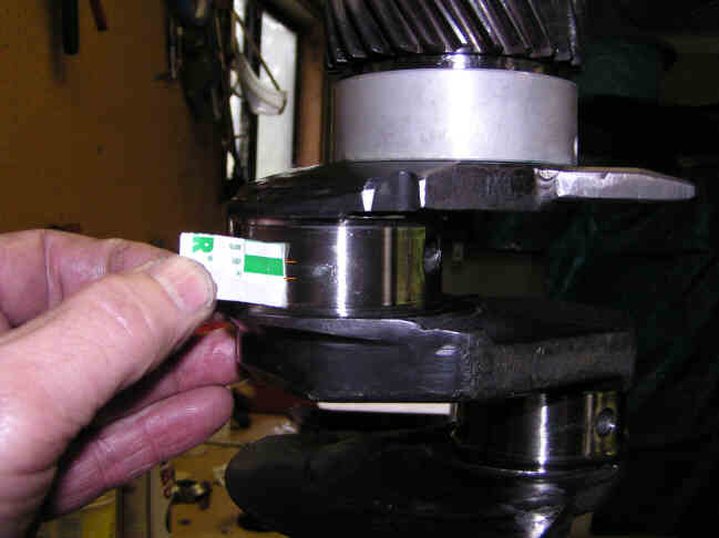

DNHunt
post Jul 15 2005, 02:03 PM
914 Wizard? No way. I got too much to learn.
Posts: 4,099
Joined: 21-April 03
From: Gig Harbor, WA
Member No.: 598
I checked the clearance with Plastigauge All 4 were .001". You'll have to trust me on this but the area between the orange lines is the plastigauge.

DNHunt   I checked the clearance with Plastigauge All 4 wer...   Jul 15 2005, 02:03 PM
