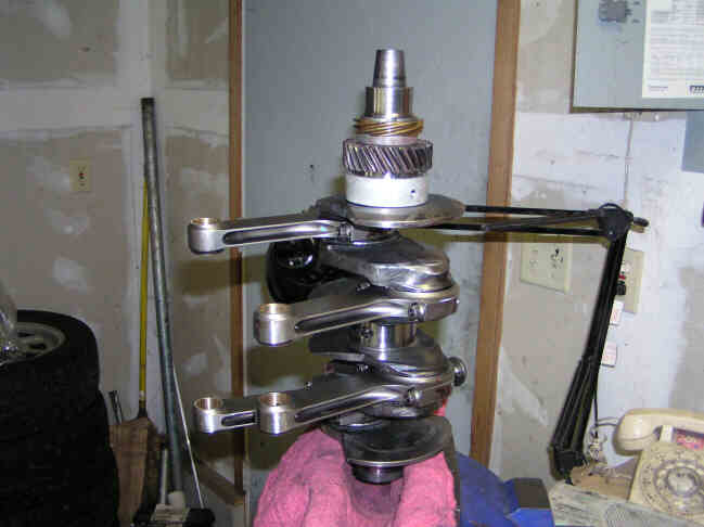

ARP rod bolts torqued to 15 then 20, then 25 and final 29 lb

DNHunt   I checked the clearance with Plastigauge All 4 wer...   Jul 15 2005, 02:03 PM
DNHunt   ARP rod bolts torqued to 15 then 20, then 25 and f...   Jul 15 2005, 02:07 PM
DNHunt   Rod side clearance.019"   Jul 15 2005, 02:09 PM
