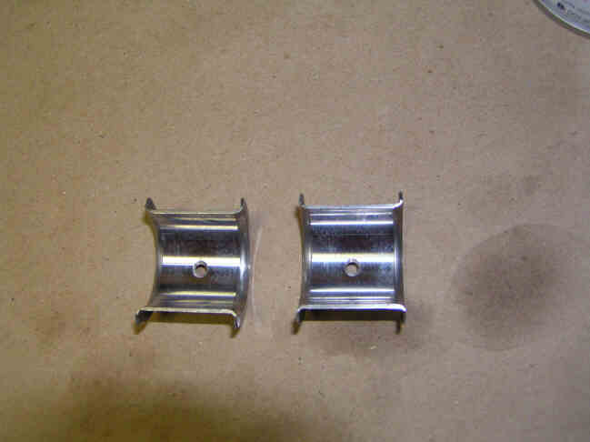

Thrust bearing have flanges which limit the movement of the rotating assembly in it's long axis (crank and cam forward and backward). This is a double thrust cam bearing. If you are building an engine you will hear about this. Both halves have trust surfaces.
