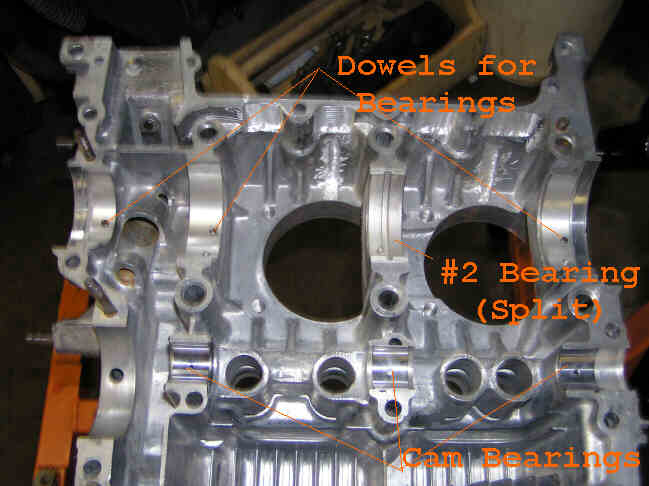

914 Wizard? No way. I got too much to learn. ![]() ![]() ![]() ![]() Group: Members Posts: 4,099 Joined: 21-April 03 From: Gig Harbor, WA Member No.: 598 |
Here are the dowels in the right side of the case. There are 4. One is hidden by the # 2 bearing half. These dowels are the reason the right side of the case is on the bottom and attached to the engine stand. They are a bitch to find if they fall out. Cam bearings are in too.
