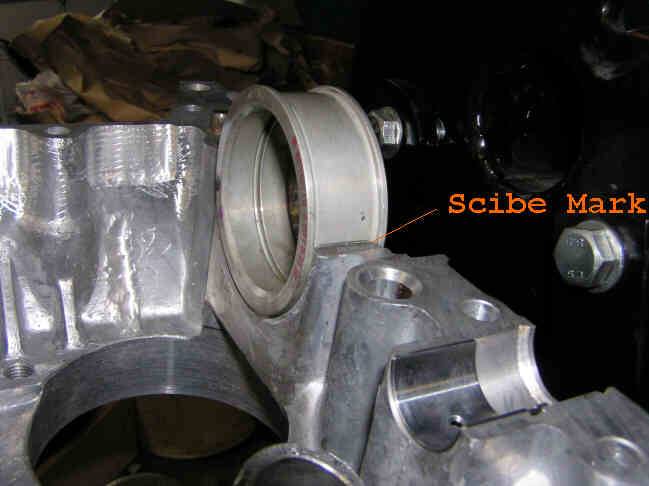

I set the thrust bearing in the case and centered it in the dowel then scribed lines on the bearing (someone far more clever than me came up with this). Then when you install the crank you rotate the bearing to the scribe marks and the dowel is centered.

DNHunt   Cam Bearings and Main bearings #1, #2 and the thru...   Jul 15 2005, 08:11 PM
DNHunt   Thrust bearing have flanges which limit the moveme...   Jul 15 2005, 08:19 PM
DNHunt   Here are the dowels in the right side of the case....   Jul 15 2005, 08:22 PM
DNHunt   I set the thrust bearing in the case and centered ...   Jul 15 2005, 08:28 PM
DNHunt   Bearing #1 scribed.   Jul 15 2005, 08:29 PM
DNHunt   Bearings scribed   Jul 15 2005, 08:30 PM

DNHunt   The scribe procedure is straight out of Jake's...   Jul 16 2005, 07:07 AM
