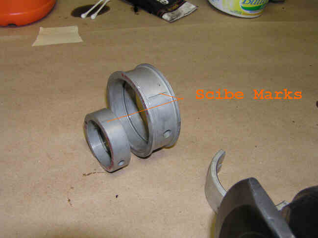

DNHunt   Cam Bearings and Main bearings #1, #2 and the thru...   Jul 15 2005, 08:11 PM
DNHunt   Thrust bearing have flanges which limit the moveme...   Jul 15 2005, 08:19 PM
DNHunt   Here are the dowels in the right side of the case....   Jul 15 2005, 08:22 PM
DNHunt   I set the thrust bearing in the case and centered ...   Jul 15 2005, 08:28 PM
DNHunt   Bearing #1 scribed.   Jul 15 2005, 08:29 PM
DNHunt   Bearings scribed   Jul 15 2005, 08:30 PM

DNHunt   The scribe procedure is straight out of Jake's...   Jul 16 2005, 07:07 AM
