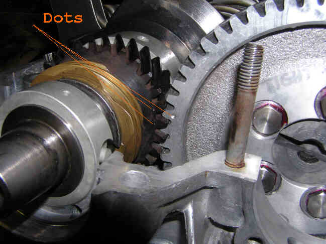

Next I installed the cam and crank. I lined up the 2 dots on the crank gear with the dot on the cam gear

DNHunt   Next I installed the cam and crank. I lined up the...   Jul 15 2005, 08:34 PM

DNHunt   The scribe procedure is straight out of Jake's...   Jul 16 2005, 07:07 AM
