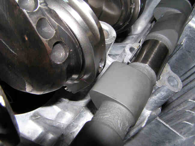

Check of clearances. Tightest spot is rod cap to cam lobe. About 2 mm

DNHunt   Check of clearances. Tightest spot is rod cap to c...   Jul 15 2005, 08:35 PM
