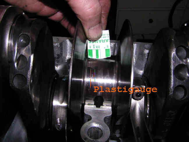

The last thing I did today was torque down the case through bolts to 36 'lbs and check the bearing squish on bearing #2. This was the only one that plastigauge would work on. It's between .001" and .0015"
