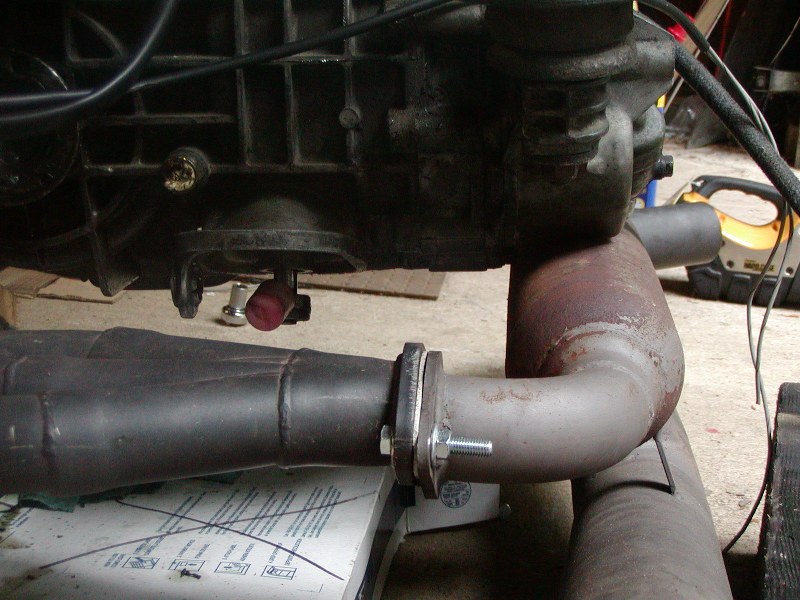

The header flanges on my SIX are too short (IMG:http://www.914world.com/bbs2/html/emoticons/wacko.gif) . Their is about a 6-8" gap between the Muffler flanges and the header flanges.
Should the header flange be close to the end of the tranny? IIRC the bracket is fairly straight when it attaches to the end of the tranny and the muffler.

Here is the situation I have. The Triad is actually upside down so it will bolt up to the headers.
I hope to have the extensions done Sunday night.

Kerrys914   Here is the situation I have. The Triad is actuall...   Jul 16 2005, 07:18 AM
rhodyguy   how long will the extensions wind up being? i take...   Jul 16 2005, 07:33 AM
