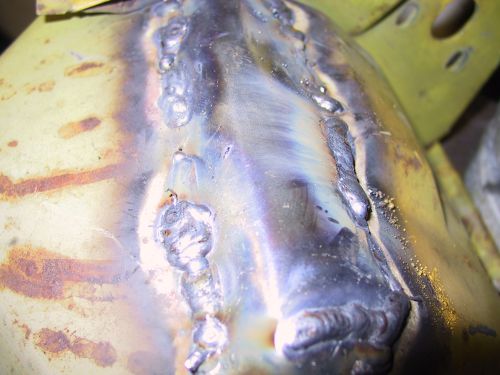

I said yesterday that I was done with rust repair. I was wrong. There's a few things left. Here's how I fixed part of the rust on the right hand side headlight bucket. Jon Lowe had removed it from the car. Here's the part before repairs Attached image(s)

Welded it in, not pretty. I promise I won't quit my day job.
michel richard Headlight bucket repair Part "un" Jul 17 2005, 11:37 AM
michel richard I cut the rut out Jul 17 2005, 11:38 AM
michel richard Fabricated a patch Jul 17 2005, 11:38 AM
michel richard Ground and cleaned up. I will fix the remaining r... Jul 17 2005, 11:40 AM![]() ![]() |
