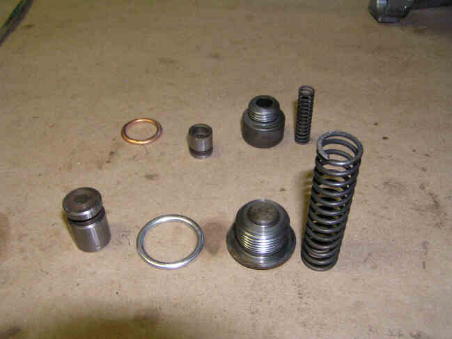

Oil pressure relief pistons. I test fit them and the pistons are nice and free in the bore. So I laid out the pieces. It was finally time to get into the gasket kit. There is a copper sealing ring for the smaller assembly and an aluminum one for the larger

DNHunt   Oil pressure relief pistons. I test fit them and t...   Jul 20 2005, 07:24 AM
DNHunt   The large one goes on the right side front on the ...   Jul 20 2005, 07:56 AM
DNHunt   I found this old square from my dad and I used it ...   Jul 20 2005, 07:59 AM
DNHunt   The small one goes between the lifter bores on cyl...   Jul 20 2005, 08:00 AM
