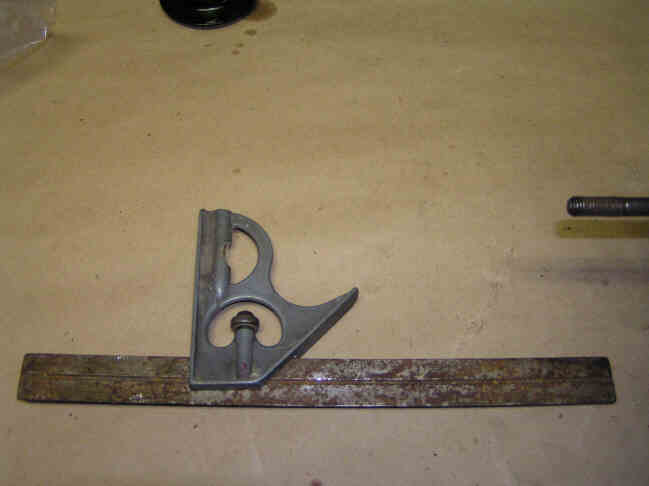

post Jul 20 2005, 07:59 AM
914 Wizard? No way. I got too much to learn.
Posts: 4,099
Joined: 21-April 03
From: Gig Harbor, WA
Member No.: 598
I found this old square from my dad and I used it with vice grips to tighten it. It fit the slot very well. Then a couple of taps with a mallet and chisel and it was seated real well
